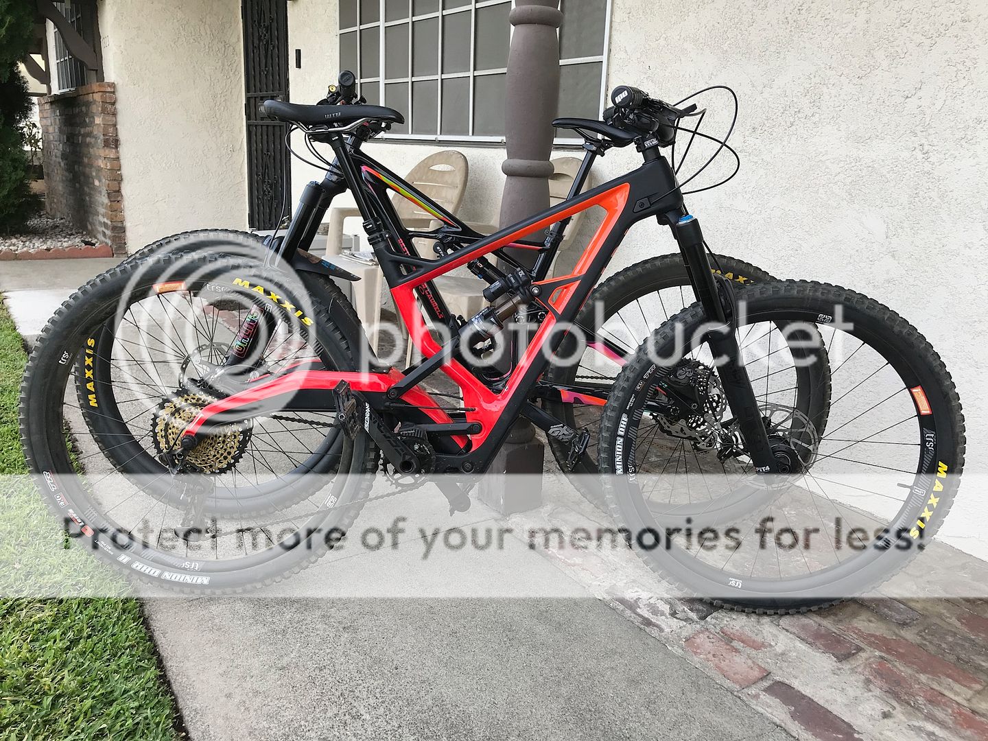

    How I picture you and your bike.
    I no longer like to party. But I like the idea of it.

    Quote Originally Posted by almazing View Post
    I love that pic...but I am not going to try to duplicate it!

    The large Wolf Ridge Pro next to my medium S-Works Enduro 29
    The handlebar and seat heights are pretty close, as well as the distance from the seat to the grips.
    My knees feel “different” after riding the Pro...not sure if that is related to the slacker seat tube angle.
    Definitely would feel better with 165 mm cranks (I have them on the S-Works).
    I normally prefer to buy used in great condition...I took the chance because at the time there were no used bikes available and it was a fantastic deal.

    Right now you're wasting your time unless you put a post with a straight/normal head on there to get the saddle into the exact same position relative to the BB as your other bikes and give it a go. You've spent that much $$ on the bike, could as well just pull the dropper and install a normal straight post before committing to a new dropper, but at least yu'd know.
