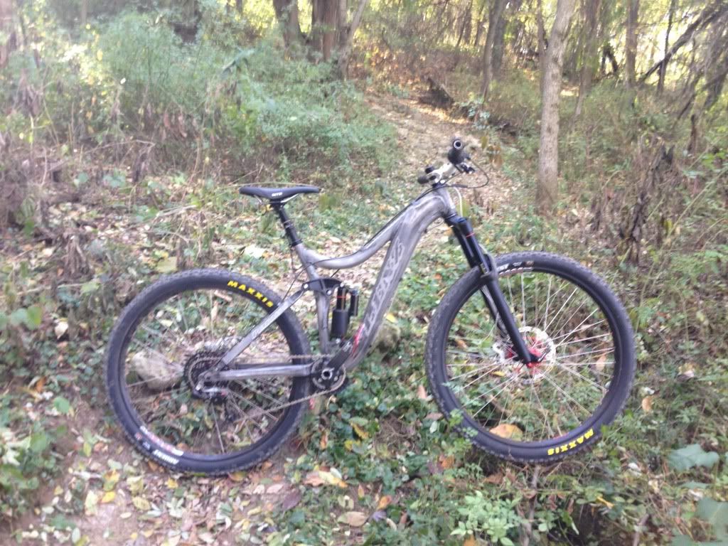

The new and improved Lenz Lunchbox.
Short chainstays? Check. 16.75 inches measured the honest way, from the center of the rear axle to the center of the BB.
Travel? Check. 150mm.
Stealth Dropper post routing? Check.
Clean-ass cable routing? Check. Rear derailleur cable runs down the downtube, inside the rear chainstay and pops out right at the derailleur. Nice.
Piggyback shocks? Check. Pick your favorite, it fits.
150mm rear hub spacing? Check. Props to Banshee for doing this as well. It matters much more than the 15mm vs 20mm fork argument.
Stiff as shizzzzzzz? Check. With the rear wheel removed, you can't budge the rear triangle. I've never had a bike that even comes close to this one in this regard.
More pics to come. I've been too busy grinning and riding to take pics.
Props to Devin Lenz on making a masterpiece, literally. He made it, with his hands, in his shop, in Colorado and it's a functional work of art.
Forgot to add, BB height is 13.5 inches with the 150mm Pike. This improvement was huge for me as I always felt the previous model's BB height was a tad tall for east coast carving. Now it slays corners. I don't have the chunk and chunder like out west, so the additional height was a hinderance to getting that "in the bike" feel. Problem solved.

Nice looking bike. Is the lower BB the only option now or can you still get the 14" BB. I live in rocky/rooty terrain so I appreciate a higher BB.
#34 ·
I'm not sure to be honest. I didn't order it "custom" so I'm thinking the lower BB is gonna be standard. I know Mike C. is running his with a 160mm Pike and hasn't had much in terms of trouble with the boulders he rides daily. I personally think the BB needed to come down some, I've ridden the older Boxes and this lower version feels much more stable and "modern" if you will.

Are you saying its chainstays are more like 16.5", being a full inch shorter than the SB95c (17.5"), when measured in the "less honest way"? The "less honest way" being a horizontal measurement from BB to axle, which doesn't factor in BB drop? Who knows if any of the measurements take sag (considering chain growth) into account.

In the original picture you posted, did you have a MTX-33 on the front?
Is that a medium frame?
This seems to fix most of the complaints I have with my medium 2010 Lunchbox frame (rear tire clearance, no piggy back shock, straight 1 1/8 head tube; I learned my lesson buying an older frame even at a really great discount).
The problem I have is that I am "higher" on my LB than on my Prime or 2010 WFO.
I have a 385 mm Reverb inserted down as far as it will go on my LB.
When measured from the floor, my LB seat height is two inches higher when slammed.
That two inches makes a big difference to me, I feel more above the bike than in the bike on corners and on steeper stuff.
Can you tell me how far your seat post can be inserted? And what is the height of the seat collar from the floor?
My LB's seat collar height is just under 33 inches and my other bikes are around 31 inches.
Does the new frame take the same size shock (7.875 x 2.0, 200x51)?
I hope they update the Lunchbox specs on their site...
I'd like to run a 6" dropper, but not if my lowest seat position will be higher since the overall seatpost length is longer and the length that can be inserted down the seat tube is limited.
I also need to verify how low my seat will be on a medium Enduro 29 with a dropper...I'll probably take one on the demo ride next month. I don't like bikes that require specific custom shocks with special mountings...but I can get a replacement CCDB air CS, which is the only shock I would want to run on that frame.

#40 ·
I'm wondering what size frame this is too. The cockpit looks a little cramped but I know pics don't tell the whole story.
I started watching some videos with Lenz bikes and they have really peaked my interest. Being a short guy, (5'-7") on a good hair day, finding a good fitting bike is tough.

I'm 5'-8", my Lunchbox and PBJ are both supposed to be mediums, their seat collar height from the floor is identical.
They do make size small...maybe I should have gotten size small (my WFO is a small and my Prime Prototype is a medium - I think the TT on both these two seem pretty close).
Not being able to test ride before you buy makes purchasing the right size more difficult.

I know the bike in johndubs photos is a medium. Can't speak to Colin's.
On a good day I'm 6'1"... Coming off a 2012 large Lunchbox. Loved the bike immensely but with the revisions Devin had made with the new version, I had to get my grubby paws on one.
That said, after much debate and conversation with a few peeps in the know, I opted for a medium. I felt the large was a bit long in the TT, mostly in the chunk. Looking for the medium to be a bit quicker and more playful.
The Lunchbox just begs to get rowdy no matter what trail you're on.

6'1" here, and I disliked the large LB. The Medium was just right.

Mine is a large, I've ridden medium Lenz's before enough to know that I personally wanted a large. That being said, I don't have the chunk/steeps that Mike does so I like a little longer top tube. Plus he's pretty short;) I'm like a whole 2 1/4 inches taller, at least.
I have mine set up with the 150mm Pike and M+ at the moment, although I might try the CCDBair again since I already have one. The M+ seems to be a good fit and match for the Pike.

I am digging this USA made bike!What is the wheelbase and standover on the medium size frame?How wide can we go on the tire size out back?Would be nice to have an optional rear with a little longer stays to fit the surly knard/dirt wizard tires.I am looking for a one bike quiver.

My medium production frame has a 45.5" wheelbase, 16.72" stays, and 29.5" standover.
I've run 2.5" Dissents on MTX33's as well as 2.5" Minion DHF's on P35's and Derby rims. Plenty of clearance for both.
I have zero interest in running Knard's or Dirt Wizard's on this bike--you'd never be able to keep air in them, and I tend to like riding more than fixing flats.

Mike can chime in as well, but I've found that the front end stays planted better on this one than other bikes I've ridden with over an inch longer stays. You have traction galore, planted front, etc. The only limiting factor is me.
The only people claiming short stays aren't important are the people not riding 'em.
I haven't found a downside at all thus far, except I don't have enough time to ride it.
Downhill stability is improved due to the lower BB and the fact that your front/center is longer with your butt over the rear wheel. The WB is long enough to be stable, but the rear is so short it keeps it lively and maneuverable for everything else.
It really does tick all the boxes. I'm very picky about ,well everything, and I can't think of one thing that I would want that this one doesn't have.
