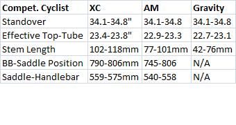

    As I stated earlier, my comments about your legs being short for your height of 6'2" were based on the measurements your posted
    For reference, I'm 6 '2.5" and these are my measurements
    Now, I'm aware that I have relatively long legs and a shorter upper body for my height, so my measurements are certainly not the norm. You can see the huge (4.7 inches) difference in the recommended stand over heights between me and you. This is based totally on the inseam measurement you entered into the calculator, so either you didn't measure correctly, or you have short legs. When you take this measurement, you need to make sure you use a large level and have the top rest firmly against your crotch, make sure the level is "level", and measure from the floor to the top of the level. This is all stated in the directions. Perhaps you measured wrong?? I take anthropometric measurements for a living, so I know my measurements are accurate. My inseam is 36" measured this way.
    If your inseam measurement is wrong (i.e., 2" shorter than it really is), I would say that you would fit better on the XL frame for sure

    Ok, so here is where I am....Below is a snapshot of measurements of my current bike, the Soma Juice in a 20" and 22" frame and a Trek Wahoo. I went to a different bike store yesterday just to test out the larger frame and liked it better. There are apparently one or two of the 20" and 22" frames left out there that I can get today or tomorrow. Based on what you've read so far can you offer more insight, especially since I wont be able to test ride the Soma frame.
