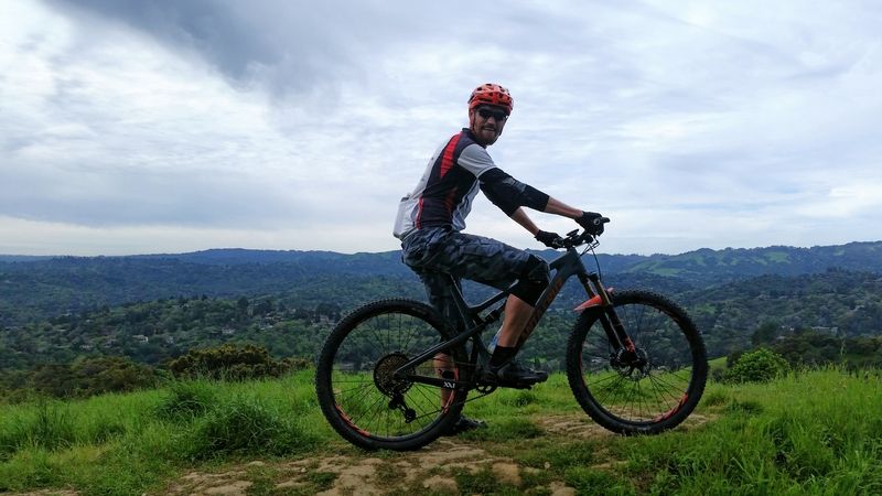

    I'll chime in with a rec for Banshee, they make a decent XL size, Reach is 488mm for the Phantom and 484mm for the Prime for 2017. FYI I'm 6'2.25" tall, 35.25" inseam, 175mm and 180mm cranks, measurement from centre of BB to top of saddle is around 32.5" depending on which bike, what length crank and what shoes, generally like to run a 785mm wide bar and 60-70mm stem.
    I currently ride the earlier Phantom in size Large with 70mm stem/785mm wide bar (450mm Reach - 470mm with a 60mm stem would be ideal), have a pre-production Prime with 475mm Reach and would run that now with a 40-50mm stem after riding the Phantom as it's set up. Thinking of picking up a 2017 XL Phantom and expect I'd need to run a 35-40mm stem with it's Reach. As said, some geo changes to both bikes for 2017, including a shorter seattube giving more stand over, not an issue for you, but would allow you to run a 175-200mm dropper. If you ran the XL expect you'd need something along the lines of a 40-50mm stem.
    Almost forgot, the KS Link suspension is absolutely amazing, when I first got the Phantom and would look down at the o-ring on the shock and see it at the end of stroke, I would wonder where it had done that as I never felt it, always felt high in the ride, but uses suspension very efficiently and fully.
    I'm 6'2" riding a 2013 XL Prime. It's the biggest bike I've ever owned, but still not quite big enough for me. I've got a 3/4" setback post, seat slammed all the way back, and an 80mm stem. And I'd still like the cockpit a tad longer, but it's pretty close.
    I have long arms and that plays a role. The new Banshees are a little longer so may get one at some point. Not a Specialized fan, but they do make XXLs last I checked.
    Works sells a headset that pushes the fork 5mm forward without changing the HTA. Considered getting one, but not sure it's worth it for that small a change.

    Wow What width bar do you run? I ran a Thomson setback post and then got a 9point8 FallLine with setback head (think it's 20 or 25mm) and run my saddle about centered on the rails, have proportionate arms to match legs, i.e. long. Guessing your flexibility is much better than mine as when I was running my XL Prime I was using a 65mm stem/785mm bar and always had trouble with controlling the front end on fast, steep stuff. When I rebuilt it last year I tried a 45mm stem and the handling was amazing, no more front end control issues.
    Good question. Just checked and it's 730mm going straight across from the edges of the grips. I guess that is somewhat narrow and I've been running those bars for a long time. Tried wider in the past and didn't care for them, plus makes it harder to clear the trees. But it's a valid point that wider bars would effectively make the bike a little longer. I do have very wide shoulders so in theory should like the wide bars. Might try them at some point.

    Me on my XXL. Doesn't look like a huge 29er.

    Quote Originally Posted by alexbn921 View Post
    How tall are you ?
    Sent from my Samsung Note 5
    Ride Fast Take Chances :)
    Reputation: alexbn921's Avatar
    2,256
    I'm 6'4" with a 35 inch inseam and long torso. Running a 50mm stem.

    I'm 6'6.
    I own an XXL SC Tallboy and and Hightower LT. Not sure there's better options out there for folks my size. Tallboy has near 3k miles on it. No issues. Fits great with a 50mm stem.
    Attached Thumbnails Attached Thumbnails Best Bikes for Tall Guys-ulrgarhes1exrludvsjxcg.jpg

    I'm 6-5" and have the exact same stable of bikes. I am happy with both
