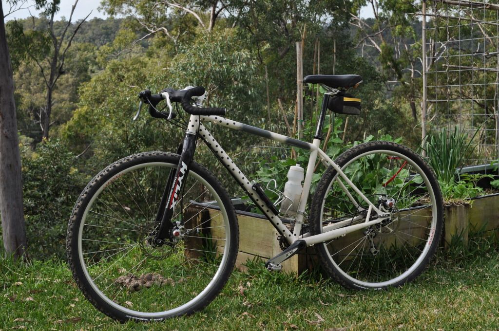

    This photo is an old one before I fixed the paintwork but you can get the idea.
    I have a 460 26er fork on my bike, where it should be 490 29er fork I guess...original geo 71.5 deg ht. For my use it works as a drop bar 29er. Turns my mtb frame into a roadframe feel basically. Very low in the BB but not as low as my roadie. Enough to clear small obstacles and feel good on the fire trails and cornering and the road. I can't imagine going to 445 though. I feel this is as steep as I would like the HT and as low as I'd like the BB. Also, I feel the steering behaves differently due to the 26er rake. It's OK, in fact I like it more than how the bike used to feel with a29er sus fork. It self centers and responds well, but doesn't have that kind of resistance I am used to feeling when steering away from straight ahead, if you know what I mean. If it is easy, just try it, but if you use it as a dedicated mtb for single track I think you won't like it.
