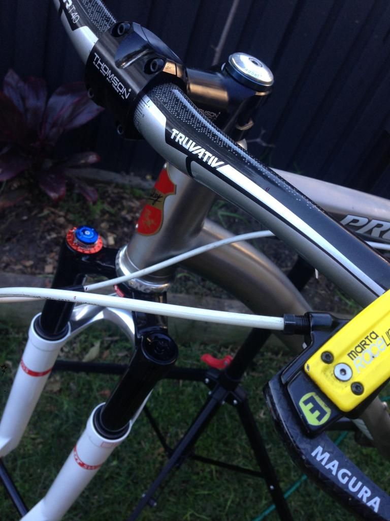

    The closes up pic of the headtube looks like it takes a 1 1/8 headset not a tapered one. According to the Lynskey website the 2014 frame is tapered any thing 2013 or older is 1 1/8. you may want to check into that before ordering parts.
    Reputation: Tubbsy's Avatar
    99
    Quote Originally Posted by Phinox View Post
    It is an older frame. But surely I can fit a tapered fork in here?
    The headtube is huge.
    Edit:
    Found this on a 2011 review of the frame here on MTBR:
    Had to source a Cane Creek lower XX44 headset cup to suit the 44mm internal diameter headtube and tapered fork steerer.
    Does this mean I need something specific?
    Reputation: Nubster's Avatar
    6,142
    If there's a serial number on the frame maybe contact Lynskey and they can give you the specs on the frame. Good people to talk to.
    Do you have the fork already or is that just the fork you are looking at? If you have it, does it fit in the headtube? If so, you should be ok. The fat part is 1 1/2" and the skinny part is 1 1/8". If the headtube is a 1 1/8" straight you should not be able to fit the fat part of the tapered steerer into the headtube.
    3,779
    I'd contact Lynskey. Everything I see looks like a 1 1/8 setup. Measure the internal diameters of the headtube. The CaneCreek headset finder seems to think it is a traditional 1 1/8 headset.
    Take a look at http://www.canecreek.com/resources/p...tion-guide.pdf
    99
    Hmm, I have the fork already. It easily fits in the headtube. Hope I haven't screwed this up.
    Will email Lynskey and find out.

    If you have calipers measure your headtube. If it's 44mm then you will want an inset 7 Chris king headset, and your fork will work.

    Reputation: elcaro1101's Avatar
    507
    That looks like a 44mm head tube to me.
    When you slide a tapered fork into a 1 1/8" frame, it will get stuck on the tapered part of the steer tube. If you can get the fork all the way to the crown, then you will be fine. It will be blatantly obvious if it is not going to work.

    Yep, the fork definitely fits in the whole way.

    Quote Originally Posted by Tubbsy View Post
    Then you want the Chris king inset 7
    Or this cane creek
    http://www.competitivecyclist.com/ca...apered-headset

    So this is the word from Lynskey:
    sure, that is just our standard oversized 44mm head tube. Any headset that provides a zero stack 44 for the top and external cup 44 for the bottom will work with a tapered steerer tube'd fork. we provide the cane creek 110 ZS44/EC44 to our customers who purchase a headset with their frame order.
    https://www.lynskeyperformance.com/s...d-headset.html
    I must say I still find the tapered standard confusing. So much jargon.

    Your tube is 44mm all the way through. The i3 is for 44 at the top 49 at the bottom and is zero stack as nubster said. Meaning even the bottom bearing is inside the headset.
    You need zs/ec
    If you want chris king, buy this http://www.backcountry.com/chris-kin...7-BOLBK-TAPINS
    Here is the best picture I can find of my bike, which has a 44mm head tube.
