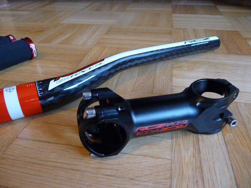

    New cockpit parts arrived yesterday! Decided to go RCZ all the way and got their carbon riser bar, an aluminium stem, and some foam lock-on grips. The bar looks really sweet! Considering the price tag at just under 40€, I think this one is a great deal.
    The stem looks suspiciously similar to the Sunline XC-1, which I also think is the exact same as the On-One Superlight and the stem offered by Superstar bikes. Must be a very good design as it's sold under so many brands...
    Had very little time to finish my build, but this weekend I will try to put the last pieces together and shorten the brake hoses. Looking forward to the first ride!!
