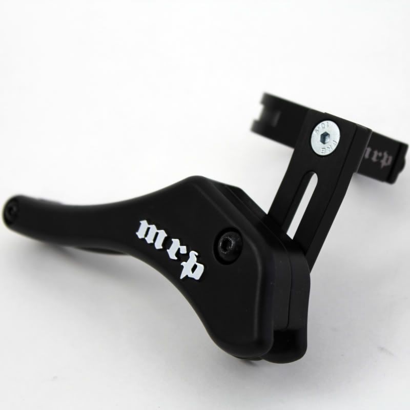

    Well there is a seat tube clamp version of the 1x now too. It's available and shipping now.

    bb-mounted MRP 1x install didn't seem too bad to me, and it has not had any problems or rubbing since
    I didn't get the angle of the backing plate exactly right the first time so I did have to pull the BB once to change that. I think it could use some marks to help orient it easier, but I guess those might not be universal enough for the different bikes it will go on.
    The cage rubbed a bit in the smallest cog using the included chainline spacer, but a single mylar washer (from any hardware store) was enough to dial it in perfectly

    The MRP chain guide with the BB mount is the only way to go. It's not that hard to install and the clean seat tube appearance is awesome!!

    I ran the MRP bottom bracket mounted chain guide on my 1x9 setup. It was pretty easy to setup but I did have the chain come off in a crash. It jammed up front and was a real pain in the arse to get un-stuck. Had to disassemble the MRP trailside and ended up stripping the tiny hex head that holds it to the BB mount.

    And the MRP 1x has been flawless. Never a dropped chain. Only way i know to have iut not work right is to have it not adjusted right

    I'm a huge fan of the MRP 1x. It's crazy easy to set up and works as advertised. I'll buy another one if I need to.

    Quote Originally Posted by NoahColorado

    The MRP chain guide works as advertised. Before you install it do yourself a favor and replace the POS screw! that holds the casing together, it's super soft and very easy to strip.

    Quote Originally Posted by Roc
    That bolt is aluminum to save weight. Standard steel bolts will hold up better, but that location really needs very little torque so the aluminum one should be fine if you're careful
