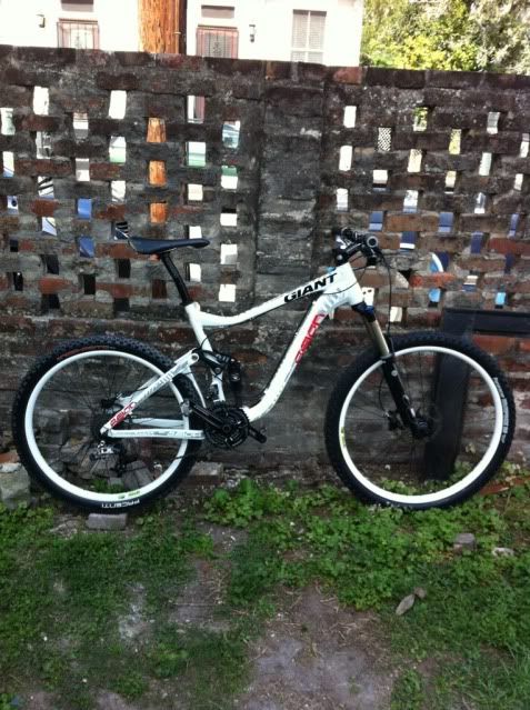

    just wanted to share my latest experimentation, a '11 reign (plain not X) with a G2 140mm revelation 29er....initial 'round the block tests are positive, can't wait to get on a trail with it this weekend or next. still have my trance 96er, just wanted to see how a longer travel 96er with higher offset fork would feel....

    just some notes:
    after messing around with the two bikes side by side, the reign as a 96er goes a fair bit closer to the ground (~3/4" more) at full compression (no air in either fork or shock) than the trance did, even though it purportedly has a higher BB meaning the difference in travel is more at the bottom end which is exactly what i was hoping for...
    also, as a side note, the reign has a direct mount front derailleur which i was surprised the trance did not get.

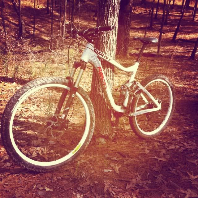

    449
    put a neomoto 650b on the rear, pretty much a game changer.
    449
    so badass:

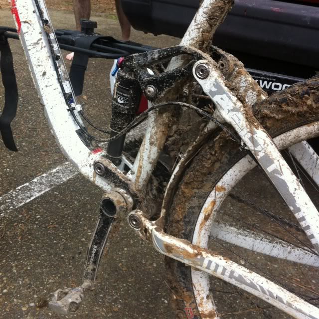

    tire clearance at one very small area of the bottom of the swingarm seemed a little too tight, but after riding it in some serious sticky mud, it is absolutely not an issue for me, YMMV.
