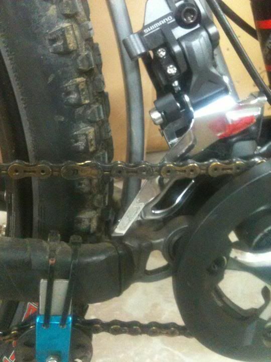

    Quote Originally Posted by energiser View Post
    I just realised you have this set up as single speed. I'm looking at buying a Reign myself especially to convert to 650b. Do you think it would still be possible to keep it with the three speed front, or would tire clearance with the FD be an issue?
    I still have the FD in my parts box, I can put it back it and try the clearance in a few days.
    14

    187
    hey energiser, the FD will clear with 2.3 neo moto at any position, so you can run 3x10 there.

    Hold it! A friend of mine just tried to build a 650b Giant Reign,brand new 2012, and the tire does not fit the frame! It is basically line to line on the lower arch.I believe that he is using Kenda 2.35s. What went wrong?

    187
    Put that 2.35 nev up front and a 2.3 neo at rear. The neo is great.

    Quote Originally Posted by g3rG View Post
    gerG
    The kenda 2.35 is too big to fit in the swing arm, drummercat is correct, put the kenda up front and use 2.3 neomoto out back
    gerG
    You picked the largest tires you could find. Try a smaller tire. The 2.35 Nevegals are huge.

    26
    Just finished my conversion to 650b with Flow EX's. I'll post pictures soon.

    Also, Energiser, did you find you had to limit either the fork or the shock? Mine seems to be just fine and very unlikely that the wheels will hit seat post or frame.

    First ride was today. Was a little hard to compare certain things, because I rode in a place I've only been a few times and the conditions were much different than normal due to the recent rain. I can say that the downhill felt very good. It rolled with very little resistance and I could feel a definite difference rolling through bump sections that would normally throw me around the bike a lot more.
    I think the best way to explain the feeling was everything felt better connected. Everything seemed to flow. Entrances to corners was faster and I would exit them carrying more speed than before, while never feeling like the wheel was too big to corner well.
    Over all It felt good, but I'm still not completely sure about it. I plan on riding a place I've done hundreds of times tomorrow so I will keep you guys updated on what I think on more familiar ground.

    Could you take some better pics of all the clearances for us.
    Give it a bunch of rides then throw the 26" wheels on and difference and improvement will become evident for the 650's.

    I wanted to add that the tires I'm running, VeeRubber 2.1's look very minimalist, but even with only a 2.1 tire gripped very well through corners and kept great roll speed.

    I've done a few rides on these rims so far and today it became so vividly clear how great this wheel size is. First off the Giant Reign is a great bike to begin with, but throwing these wheels on here makes it feel limitless. The climbing on it doesn't feel so sluggish like it does when trying to power up a 29er up a hill, much better acceleration, but it still gives a great benefit of rolling over objects better. There's a section where I was riding today (Aliso Woods for those who know the area) that comes out of a very fast corner, straight into a short steep, rutted-out climb. This was the second time I had been here so I didn't know it was around the corner, but I quickly jammed down a feel gears and flew straight up the steep section like it was nothing. I looked back at it and could barely contemplate what had just happened. Very good feeling.
    Secondly, the trail I went down today is filled with rock gardens, switch backs, drops, etc. Very varied trail is the point. Never has a trail felt so fluid even with that many obstacles. It just clicks.

    I finally did the conversion and like a dumbass, I tried with a pair of less expensive wheels (Sun Inferno 27) and the Neo-Moto 2.3 tires would not setup tubeless; however, I decided to do it right and got myself a set of ZTR Flow EX with 3.30 hub and had absolutely no problem getting it tubeless with a floor pump. I just needed to buy the 15mm hub adapter for the front.
    I'm sure about total overall weight, as I don't have a scale to a true measurement, but I'm pretty sure these are no heavier than the stock DT Swiss EX540/Nevegal setup. I only rode them once for an hour at my local trails and I'm not really sure what to think... It also doesn't help that I haven't ridden in almost 5 weeks and just got over the flu so I was dehydrated and weak... I need to ride again this coming weekend when I'm fully recovered and post some comments.
    I must admit, these rims look nice! I posted some pics for those interested.

    fyi, the first 4 pics are just rims only (no tires mounted) in case you are going with a different tire...
