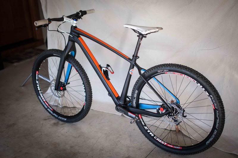

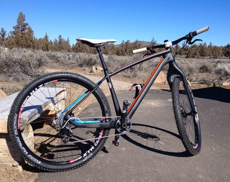

  17. #317
    May 2010
    167
    Quote Originally Posted by BlueDragonX View Post
    I believe they all have a 71* head angle or close to it. They take a tapered integrated headset. The Project 321 stuff is all for straight 1 1/8" steerer tubes, so with the appropriate headset you should be fine.
    As to what BB is appropriate for SS... On these frames (and any frame with vertical dropouts) you can either use a chain tensioner or an eccentric bottom bracket (EBB) to take the slack out of the chain. An EBB requires BB30. As I understand it most people prefer the EBB over the chain tensioner.

    It should look something like this
    Lefty Carbon XLR 29er
    Light Bike 650b carbon hoops
    321 front hub
    Chris King rear hub (I have a hub and a Chris King hub service kit sitting around)
    Cranks?? Not sure yet
    680-700mm bars Carbon
    Eggbeaters
    XT brakes
    Kind of excited to see how little it weighs, Ill post pics and weights as the build comes along
    -FreuderLocks

    I finished mine this morning and road it to work:
    I'm really happy with how it turned out!
    That's a great looking commuter bike. Are those schwalbe marathons? I just got a set for my cross bike. Let me know how you like them.

    Quote Originally Posted by man and machine View Post
    Thanks. They're Big Bens actually. I like them so far though getting them to seat all the way on the Arch EXs I'm using is a pain in the ass.

    Chinese Carbon Frames - 650b edition-imag0419.jpgChinese Carbon Frames - 650b edition-imag0418.jpg
  62. #362
    Reputation: Chad_M's Avatar
    Jul 2013
    491
    The last 2 builds posted looks great

    IP 156 Full Suspension 650b build
    I ordered up my second Chinese carbon frame, this time from XMIPlay. I previously bought and built up an FM 136 from Hong-Fu bikes and have been very happy with that bike. I decided to try a full suspension 650b to replace my old Ellsworth Truth. I would've considered a new 650b Truth, but their pricing is just stupid. So, for $700 I bought the 120mm travel full suspension IP 156.
    The build:
    IP 156 frame
    Fox rear shock
    Fox 120mm Float fork
    Rotor cranks and elliptical ring (1x10)
    Shimano XTR Shadow + derailleur and shifter
    Speeddream wheels with Chris King hubs and Stans Crest rims
    Formula R1 brakes
    22.5lbs
    I've now ridden the bike several times on various technical singletrack for about 50 miles and can say that this bike is a great upgrade from the old Truth. I was a bit concerned with the increased wheelbase, but really can't feel it on the trail. The suspension is very plush, yet the bike carves nicely and even climbs better than I expected. Not as good at climbing as my hardtail, but better than the old Truth. I do like the rollover of the 650b front and rear. I've been riding 650b for a few years now, but only in asymmetric setups (B6 and 9erB). So this is my first square 650b setup.
    The quality of the frame is top notch. No issues at all with the build up or after riding. The drive side chain stay is close to the chain, so you do get some chain slap, even with a Shadow+ derailleur. I would also recommend upgrading the headset as the one they spec is a bit cheap. You can buy the FSA equivalent for about $45. I ordered the frame from Peter XMIPlay and he was great at correspondence and follow up after the sale.
