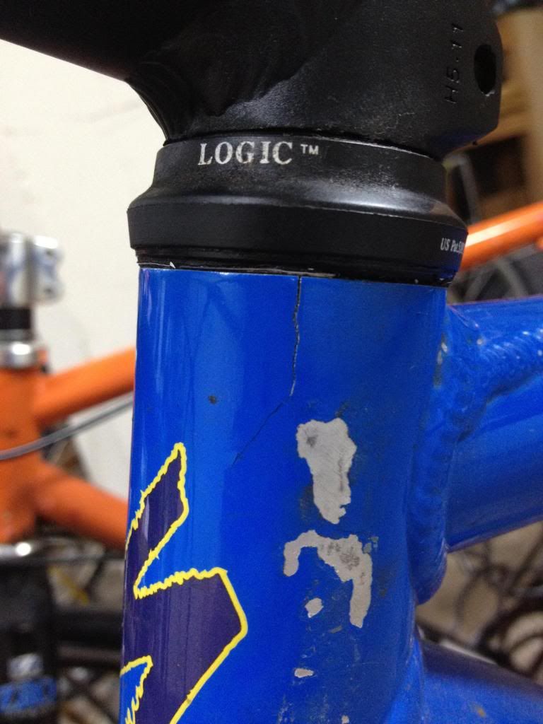

    I have an old Rockhopper with a cracked frame, but its a slight crack, and I think I might just make it into an around town bike, but I was thinking it would be cool to add 27.5 rims. I will try to see if the LBS will let me put them on just to see if they even fit, but the bike does not have disc mounts, so if there aren't any 27.5 rims that accomodate rim brakes, I'll throw the idea out the window.

    Quote Originally Posted by magnato1 View Post
    Hey all,
    Cracked frame? The only thing one does with a cracked frame is get rid of it.

    Oh yeah... And throw that frame away. Mr5150 is right.

    Another vote for scrapping the frame.

    Aluminum frame... scrap, sorry.

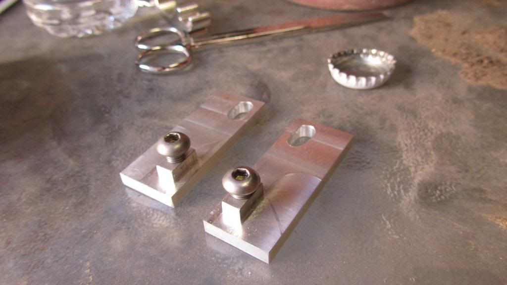

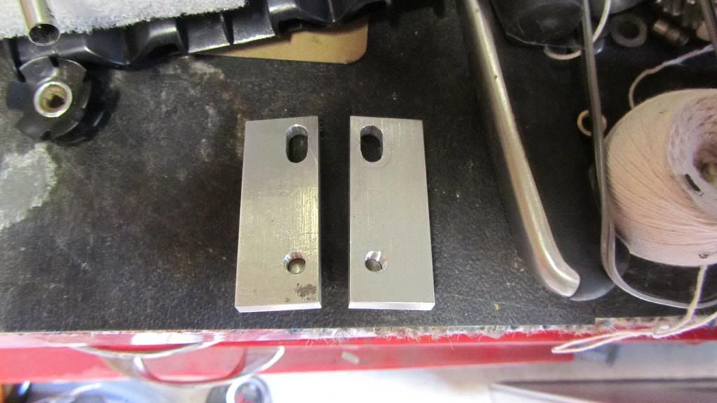

    Reputation: proto2000's Avatar
    688
    V-brake adaptor
    I manufactured some adaptors for a friends 26" bike to accept 700c wheels and use the V-brakes. No pics of the finished product on the bike but I think the slots would accommodate 27.5, if not just make the slots longer. I did do machining after I got the adaptors on the bike to see what would look better than a couple of square chunks of metal hanging on the brakes and I must say, they look pretty good once installed. What you see is the raw form before matching them to the brakes and frame for a more sleek look.

    So, all I want to do is ride the bike around town, literally as a road bike. You still think I have to scrap the frame?

    Are you the original owner? if so, warranty it. If not, throw it in the trash can.

    This. The only way to fix that is to replace the headtube and it's not worth the trouble for a Rockhopper. It will eventually fail, possibly while you're just riding it around town.

    I'd scrap it no matter what, especially with a head tube crack.
    If you insist on keeping it, stop drill the crack.

    I am an the original owner, but it is a 96 RockHopper. Not sure that they will warranty it, but I guess it's worth a shot. Can I do the warranty thing myself or do I have to go through a shop?
    I'm bummed, I figured you guys would say it would be fine if I was just riding around town. It's the first bike I ever bought and even if they warranty it, it will be lost to Specialized. I've never seen another one in this color scheme or frame style from the same year. It's a RockHopper Comp A1 FS.

    Specialized offers a lifetime warranty on the front triangle. As long as it is not abuse, you will get a new frame. Take it back to where you bought it.

    Quote Originally Posted by proto2000 View Post
    Sinz - BRAKING, BRAKE POST EXTENSION

    If you cant get Specialized to get you a new frame, then dont throw it recycle it!

    For sure, I'm not one to waste. LBS is working on a warranty claim for me, I'll keep y'all posted on the result.

    A crack this big in this spot is a definite safety hazard. This frame should be replaced. Continuing to ride it in any capacity ain't worth the risk.
