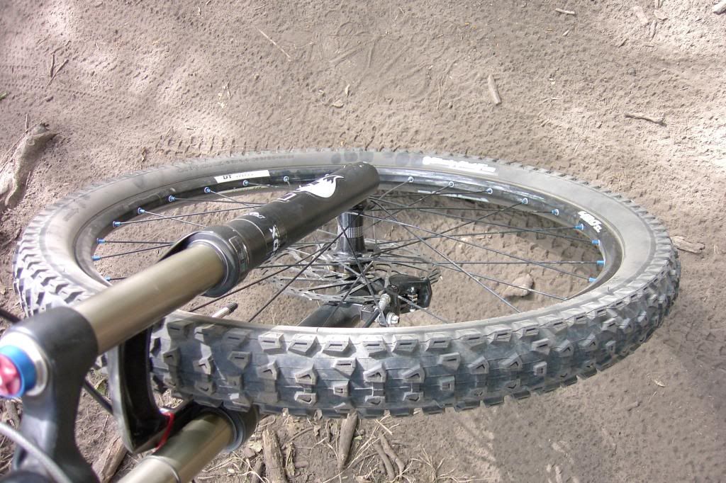

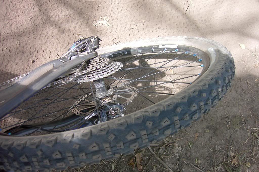

    I was in the same boat...
    Hi Pete, I was in the same boat as you a few weeks back. My old Specialised FSR xc was still in good nic and after riding some plus bikes the tyres need to go on a fat diet
    I also changed the fork as well to a 27.5 size so front tyre clearance was no problem. The rear tyre originally was a 2 inch, was not sure if a 2.3 would fit.
    The local Specialised dealers were having a two for one deal, so a cheap up grade I am now running 2.3 front and back.
    Up front the Purgatory
    Out back the Ground Control.
    Very happy with this setup, enough clearance on the rear so no issue with tyre rub. Plenty of grip and with lower pressures, comfort is also better.
    Cannot see much point running wider tyres than these on a xc bike.
    Hope that helps.

    Quote Originally Posted by Pedals On View Post
    I have read descriptive writeups for this tire for a few weeks. I can use Google all day just like the next man. I was just looking for actual feedback on a personal level. Thanks for the info..
    Sent from my SM-G920V using Tapatalk
    Sorry, I was only sending you the link so you could see exactly what I bought. The side walls feel fairly firm, but not as much as my Mountain King. I was out again last night and it handled like a champ, even in a little mud. I say go for it, I really don't think you will be disappointed.
    JORBA Member
    Apr 2016
    181
    Quote Originally Posted by Erock503 View Post
    Thanks for the pics, tire looks great. That fork is screaming for an overhaul though!
    Haha yeah I know.. it's like 20 years old, but still handles like a champ!

    Those tires will flex like shit on narrow rims. That's the whole problem. People kept asking tire makers for wider tires with more volume. But rim tech wasn't there to make a light wide rim. Wide rim have been around for a long time. But they have always been too heavy to be of any benefit. Now with carbon, you can have a much wider rim with the weight of a narrow rim. You don't realize how much wide tires flex on narrow rims until you try them on wide rims. On narrow rims you have to run high pressures to keep rims safe. Which means you're not really able to take advantage of the tires width. I tried 3" tires in narrow rims years ago. They were horrible. How I can have great traction, and a strong light rim/tire at a low psi. And, my setup is lighter than my aluminum wheelset with 2.25" tires. It's all win!
    You can read how much a tire deflects on modern rims here.
    Is wider always better? - ENVE Composites
    I couldn't tell you the internal width of the rims I was running then. They were Sun Double Track somethings? Sun Ringle? That may've been the hub. I'll have to find a picture and check what they were. The issue with wide tires then wasn't the flex, or even the grip. It was weight.
